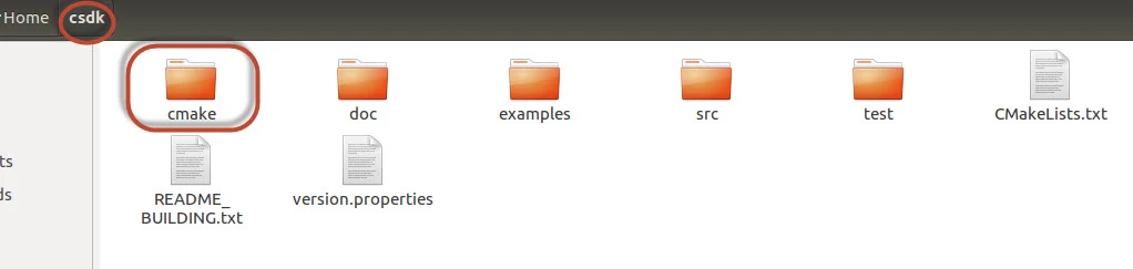

1. create a directory under the c sdk root folder, with any name something like this
I have named the folder as cmake, notice that i am under csdk folder which contains the CmakeLists.txt

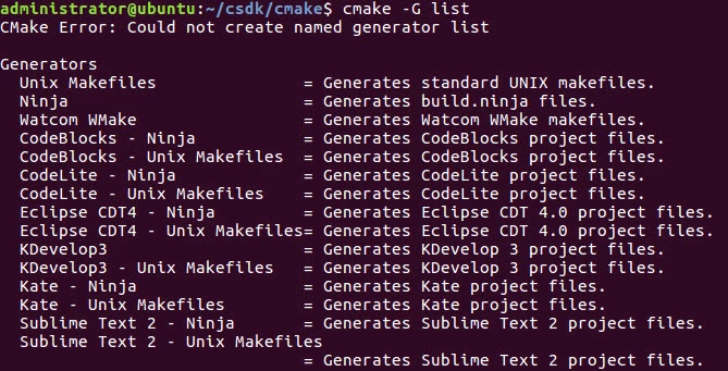

2. CD into the cmake and check for the available compilers with cmake -G list
and then use the required compiler e.g. cmake -G  "Unix Makefiles" ..

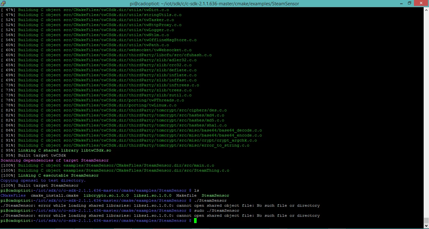

Hi ,
I followed each steps as you suggested, i can get build files but when i run "./SteamSensor"  the library files not loading,
I have attached a Screenshot of that. Please Suggest me what should i do.
The steps i have followed:
1) Made changes in  (SteamSensor example folder)   TW_HOST ,TW_PORT and AppKey
2)Disabled HTTPS in twLinux.h file (porting folder)
3)Followed your Steps
