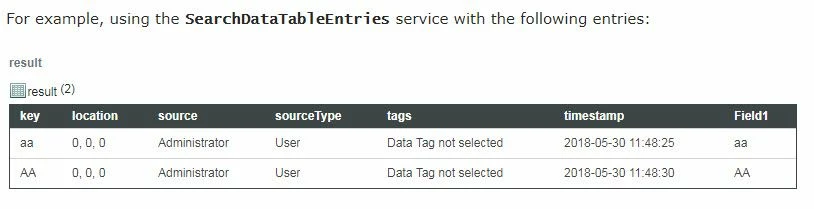

    September 1, 2020
    Hi Raccone
    As my understanding, you can identify the optional parameter business meaning only if we pass the required parameter type (such as string type, infotable type).
    Based on help center introduction regarding Data Table Services, provide below demo for understanding the meaning of the parameters (even though below table is the output of another service):
    Below is my demo fragment for values:
    var values = Things["VendingMachineInventoryTable"].CreateValues(); //or    var values=me.CreateValues();
    values.productID = ProductID; //STRING
    values.currentInvQty = Current; //NUMBER
    values.vendPosition = Position; //NUMBER [Primary Key]
    values.positionCapacity = Capacity; //NUMBER
    values.productPrice = Price; //NUMBER
    Best Wishes!
