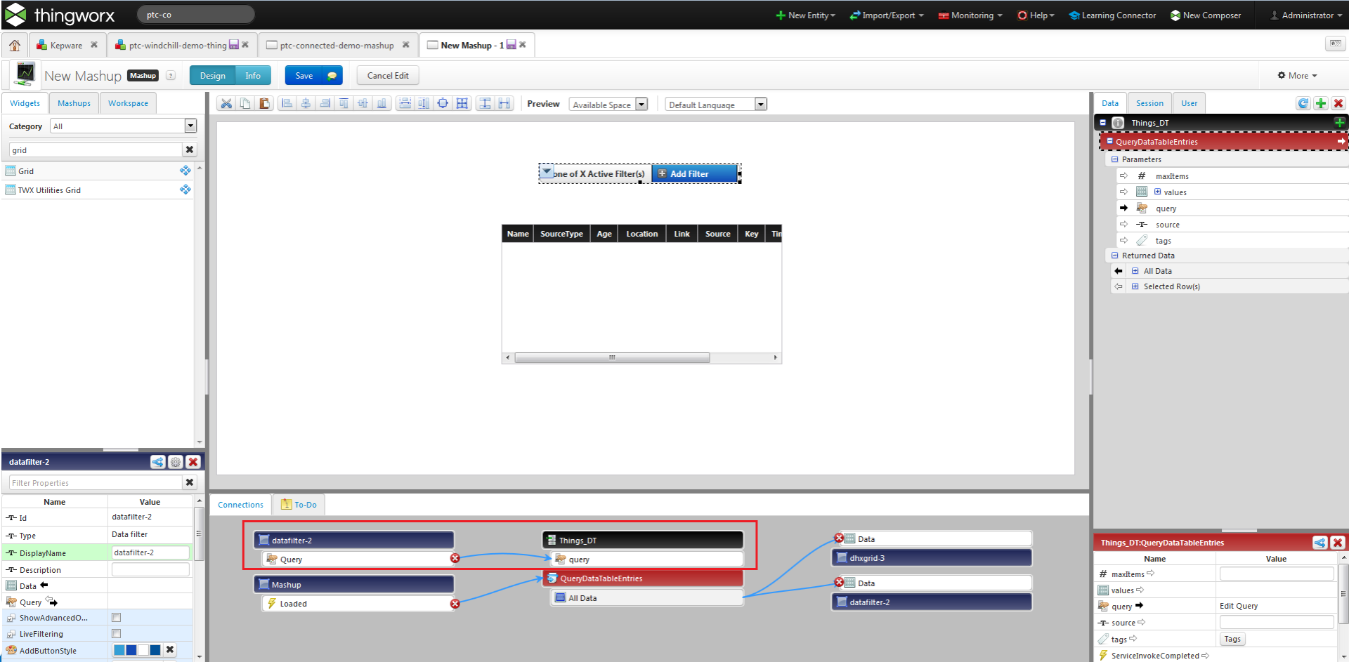

For your case, I suggest using Data Filter widget.
BR,
Lily

Mr. Guo wants to filter data table data with textbox values and customized service. It OK, but I suggest using DataFilter widget, which does not need customized service. It would be easier.
By binding data filter's query to the service QueryDataTableEntities's parameter query.;
