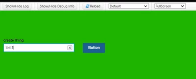

I want to validate a ThingName in thingworx. Like In Mashup, when I type a thing name in textbox field and enter on click button, the validator function should be check the thing which we have enter in textbox field is already available or not, if  yes the message should be Thing Created Successfully and if not then should be Thing Already Exist.
So how can we do that?
Thanks.

Instead of Clicked Event to show a status message. Use ServiceInvokeCompleted Event from the service to trigger/show popup message.

Instead of using validators, you could have the service where you create the thing return a status message with either success or failure message.

You cannot use the validator function to check whether Thing exists.
As @Rocko said you can use the service to validate it. Something like this
let result = "Thing already exist";
if(!Things[thingName])
 //Put your Script to create Thing
 result = "Thing created successfully";

After this  I m not able to see notification like Thing already exist or not in mashup.
