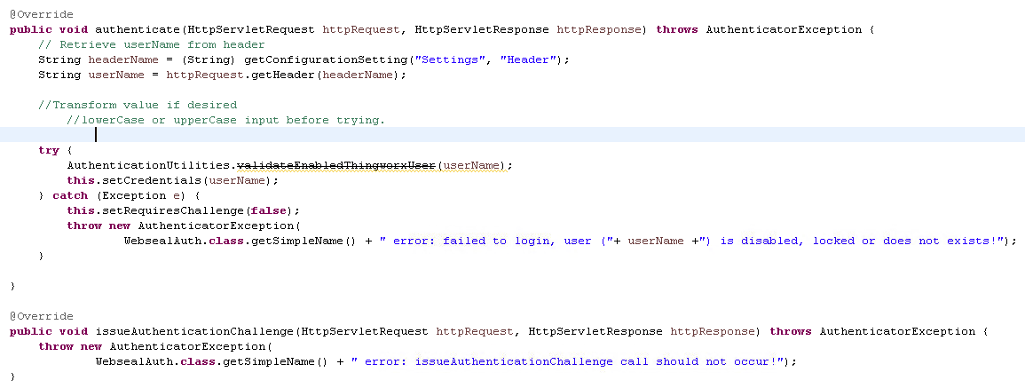

In custom Authentificator, I have this code and it works fine:
Since validateEnabledThingworxUser is depricated in favor of validateThingworxUser, I changed the method.
Now I am getting error:
Authenticator threw an exception while invoking authenticate(...), authenticatorName=WebsealAuth, exception=tried to access method com.thingworx.security.authentication.AuthenticationUtilities.validateThingworxUser(Ljava/lang/String;)Lcom/thingworx/security/users/User; from class
What has changed? Cannot find anything in JavaDoc, how is that even possible when using catch with custom Exception?
Any help would be appriciated? Silvia Balta​ related to our case.
Best answer by jgabriel
Ok with sdk 7.3.1 there is no validateThingworxUser and validateEnabledThingworxUser does not throw deprication and everything works as expected. You should use validateThingworxUser instead of validateEnabledThingworxUser from 7.4.x forward.
I can confirm that problem was caused (on my part) by version missmatch using 7.4.x sdk on 7.3.x Thingworx. Marketplace package did not have version in file name, which resulted in me not checking compatibility...

Also issueAuthenticationChallenge gets called even if setRequiresChallenge(false); with deprecated validateEnabledThingworxUser.
A bug maybe?
jgabriel1-VisitorAuthor
June 22, 2017
this.setRequiresChallenge(false) does not seem to make any difference. I would like to pass to next Authentificator without needing to enter issueAuthenticationChallenge and throwing seccond exception.  Is it possible?
Also new method mentioned above throws exception I can not catch with this code snippet, any ideas? (Have to stay with depricated for now?)

Can you tell me which version of the Extension SDK you are using? I don't have any issues like this in the older version, but I can test a newer version to verify if there are bugs or not (and it certainly sounds like there may be). You mentioned a case for this, can you tell me the number? I think this issue with "stRequiresChallenge" may need its own case, if it doesn't have one already.

Jan Gabriel​ I'm not sure if my previous comment was sent; what is ThingWorx behavior when you get the "Authenticator threw an exception while invoking authenticate..." error? Does the Composer load? Or is there other behavior?
