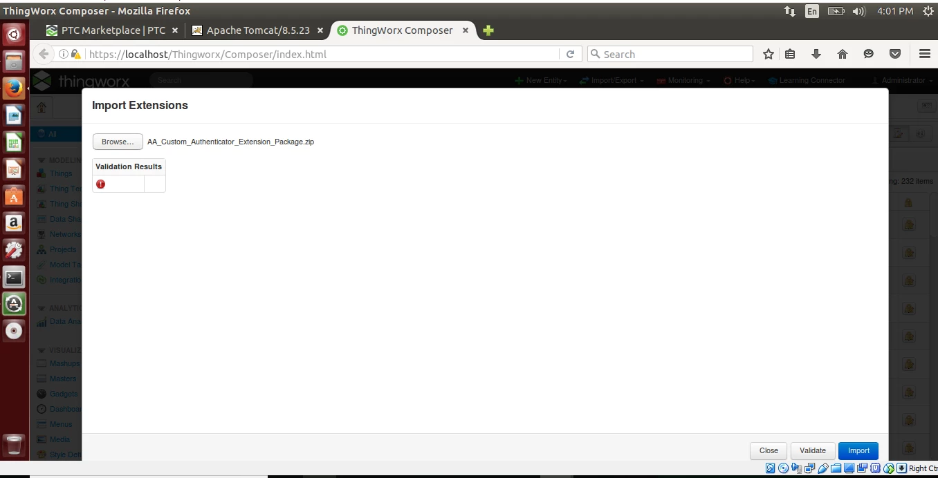

i am  installing the thingworx 8.2 in linux after the installation of the composer we have to import the entities.while importing the entities i facing as error as Validation when i upload a entity and choosing the path when we try to import there will be validation error so the zip file wont be imported so anyone can help me out. i have uploaded the image for referring to the error. but while importing the utilities entities from the PTC network i was able to import it successfully.

but there as ghost entity created while trying to import the other entities so i couldn't import. so tried importing the ghost entity it worked. sorry for the late reply.
October 16, 2018
As you noted since you were able to import utilities extension the issue is most likely with the other extension you trying to import.
Can you also attach the extension zip file as well as application log snippet from the time you run the import?
