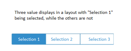

I want to create a button with a label on it that is responsive and that can change the display style based on a "Selected"-state. As I don't want to use anything like Tabs or the fixed size buttons, I thought to use a value display. But the problem is that the value display removes the Label-property if it is used in a responsive container (layout).
Is that a bug?
Here's an example of what I try to achieve.
F.
