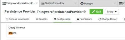

I assume the failure you get is that the timeout for DB queries is 600 seconds. And as you have so much data the deletion query just needs very long.
You can change this timeout or change your purge mechanism (depending on amount of data you have). 1. Maybe purge multiple times with different start times (first run purge all data older than 10 months, second run all data older than 9 months, ...) so that each run only deletes like 1 month of data.

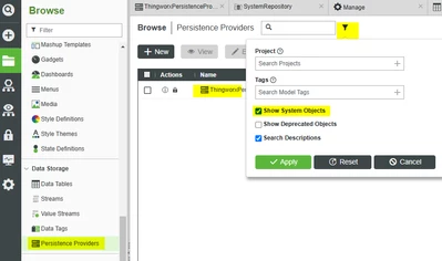

2. You can configure query timeout in "ThingWorxPersitenceProvider"-Entity:
But this setting applies for all queries to database. It may impact platform performance in certain conditions. So better alternative is to fine tune your purge mechanism 🙂
