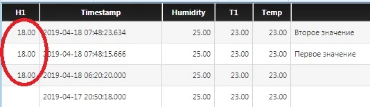

I have a remote thing which reports temperature and humidity, sensor is connected to Rapsberry.
I have set temp and hum prorerties as persistent and logged, and have Value Stream assigned to thing.
So, I can see property values, and I can observe their values changing over time.

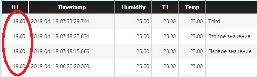

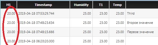

But when I query property history, I see, that property changes are not logged over time, but values updated for several last rows with new value (leaving the original timestamp). I attach pictures for better understanding.
So, what is wrong?

Can you run QuerynamedPropertyHistory service for H1?  Your H1 value has been updated but it shouldn't change like that, either you changed property history or something wrong happened in your VS.
