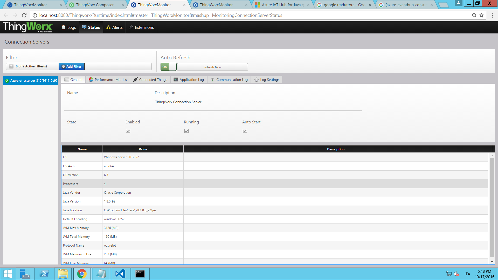

Oct 17, 2016 4:17 PM UTC

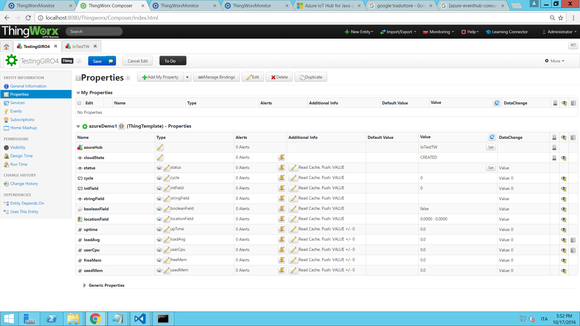

I correct 2  problem that i mentioned up, I have a issue in the .conf  file.
So..
The azure iot connector opening web socket corectly. I'm able to create, delete, import, device from IoThub.
BUT I can't read messages/values from that device !! I'm using the demo( in the documentation of setup iot connector) to create random values.
My configuration is:

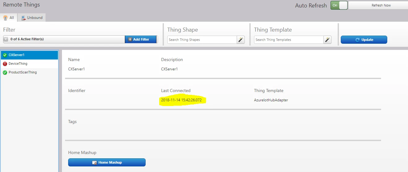

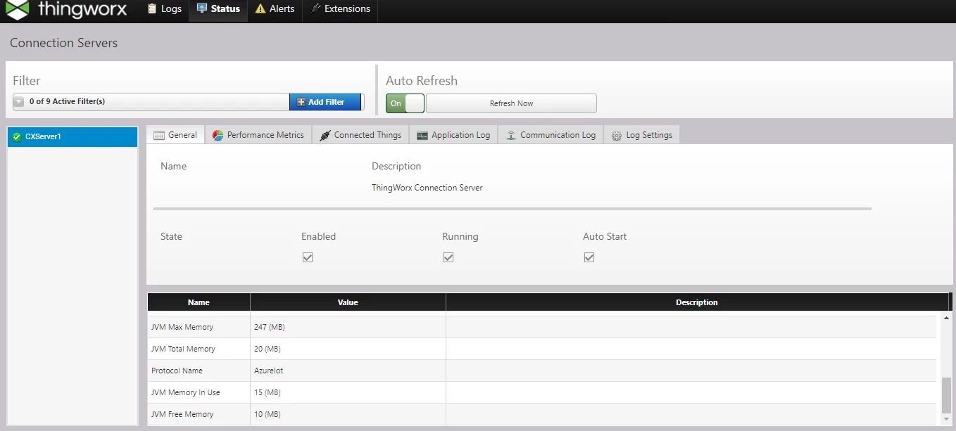

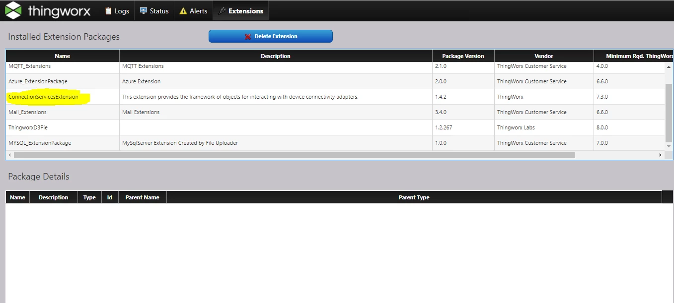

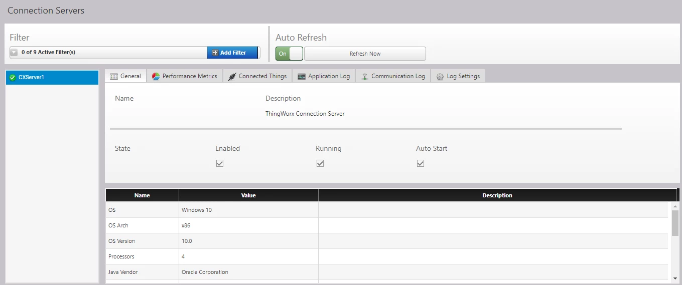

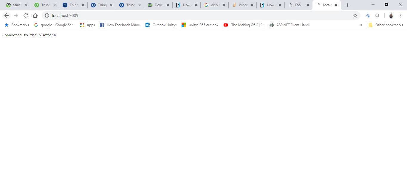

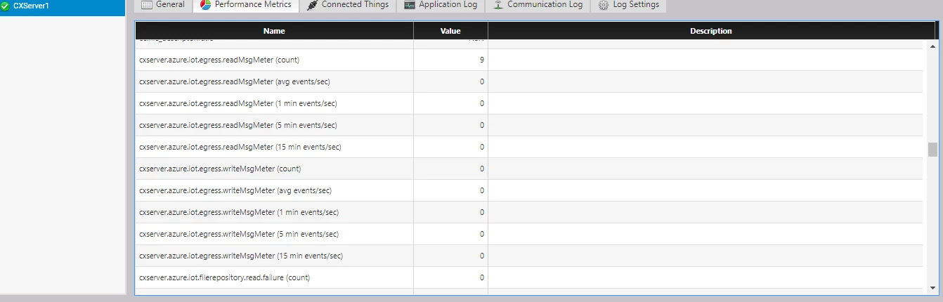

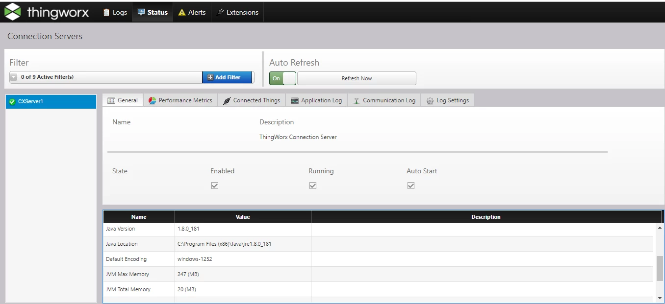

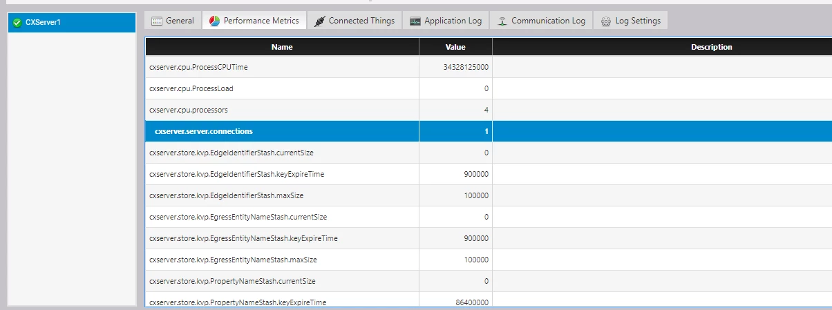

Nov 21, 2018 11:25 AM UTC
I am able to make connection between thingworx composer and thingworx-azure connector. But not sure if I am connected with Azure. My logs doesn't give me that indication. Also I have attached few screenshot which shows thingworx composer is connected with thingworx-azure connector. Can you please suggest how can I make connection IOT hub? Below are my logs details.
12:44:37.631 [main] WARN c.t.c.p.s.k.impl.StoreServiceImpl - The contents of cache: ThingNameStash will never expire: -1. Consider setting 'default-expire-time' or the cache 'expire-time'.
12:44:38.015 [main] WARN c.t.c.metrics.MetricsReporterManager - Metrics are enabled but no reporters are configured
12:44:39.510 [Thread-11] WARN servicebus.trace - UnHandled exception while processing events in reactor:
java.lang.NullPointerException
org.apache.qpid.proton.engine.impl.EventImpl.dispatch(EventImpl.java:112)
org.apache.qpid.proton.reactor.impl.ReactorImpl.dispatch(ReactorImpl.java:309)
org.apache.qpid.proton.reactor.impl.ReactorImpl.process(ReactorImpl.java:276)
com.microsoft.azure.servicebus.MessagingFactory$RunReactor.run(MessagingFactory.java:375)
java.lang.Thread.run(Unknown Source)Cause: null
java.lang.StringBuilder.<init>(Unknown Source)
org.apache.qpid.proton.reactor.impl.ReactorImpl.getConnectionAddress(ReactorImpl.java:445)
com.microsoft.azure.servicebus.amqp.ConnectionHandler.onConnectionInit(ConnectionHandler.java:43)
org.apache.qpid.proton.engine.BaseHandler.handle(BaseHandler.java:116)
org.apache.qpid.proton.engine.impl.EventImpl.dispatch(EventImpl.java:108)
12:44:39.525 [pool-5-thread-1] ERROR eventprocessorhost.trace - host AzureIot-2aaa9290-7e55-4b2c-abb5-d9c6a6f71e8e: Exception while initializing stores, not starting partition manager
12:44:39.525 [pool-5-thread-1] ERROR eventprocessorhost.trace - host AzureIot-2aaa9290-7e55-4b2c-abb5-d9c6a6f71e8e: Caught com.microsoft.azure.servicebus.IllegalEntityException: Failure getting partition ids for event hub
12:44:39.525 [pool-5-thread-1] ERROR eventprocessorhost.trace - host AzureIot-2aaa9290-7e55-4b2c-abb5-d9c6a6f71e8e: com.microsoft.azure.eventprocessorhost.PartitionManager.getPartitionIds(PartitionManager.java:71)
12:44:39.525 [pool-5-thread-1] ERROR eventprocessorhost.trace - host AzureIot-2aaa9290-7e55-4b2c-abb5-d9c6a6f71e8e: com.microsoft.azure.eventprocessorhost.PartitionManager.initializeStores(PartitionManager.java:211)
12:44:39.525 [pool-5-thread-1] ERROR eventprocessorhost.trace - host AzureIot-2aaa9290-7e55-4b2c-abb5-d9c6a6f71e8e: com.microsoft.azure.eventprocessorhost.PartitionManager.initialize(PartitionManager.java:106)
12:44:39.525 [pool-5-thread-1] ERROR eventprocessorhost.trace - host AzureIot-2aaa9290-7e55-4b2c-abb5-d9c6a6f71e8e: com.microsoft.azure.eventprocessorhost.EventProcessorHost.lambda$registerEventProcessorFactory$0(EventProcessorHost.java:509)
12:44:39.525 [pool-5-thread-1] ERROR eventprocessorhost.trace - host AzureIot-2aaa9290-7e55-4b2c-abb5-d9c6a6f71e8e: java.util.concurrent.FutureTask.run(Unknown Source)
12:44:39.525 [pool-5-thread-1] ERROR eventprocessorhost.trace - host AzureIot-2aaa9290-7e55-4b2c-abb5-d9c6a6f71e8e: java.util.concurrent.ThreadPoolExecutor.runWorker(Unknown Source)
12:44:39.525 [pool-5-thread-1] ERROR eventprocessorhost.trace - host AzureIot-2aaa9290-7e55-4b2c-abb5-d9c6a6f71e8e: java.util.concurrent.ThreadPoolExecutor$Worker.run(Unknown Source)
12:44:39.525 [pool-5-thread-1] ERROR eventprocessorhost.trace - host AzureIot-2aaa9290-7e55-4b2c-abb5-d9c6a6f71e8e: java.lang.Thread.run(Unknown Source)
12:44:39.525 [pool-5-thread-1] ERROR eventprocessorhost.trace - host AzureIot-2aaa9290-7e55-4b2c-abb5-d9c6a6f71e8e: Inner exception com.microsoft.azure.servicebus.ServiceBusException: java.lang.NullPointerException, TrackingId: 7b47ba83-1d67-496b-bbf0-e0f3f4d752b4, at: 2018-11-16T12:44:39.523+05:30[Asia/Calcutta]
12:44:39.525 [pool-5-thread-1] ERROR eventprocessorhost.trace - host AzureIot-2aaa9290-7e55-4b2c-abb5-d9c6a6f71e8e: com.microsoft.azure.servicebus.MessagingFactory$RunReactor.run(MessagingFactory.java:397)
13:56:52.584 [ConnectedStateListener-executor] WARN c.t.connectionserver.CXThingImpl - Lost connection to platform
Aug 10, 2017 9:02 PM UTC
This error is innocuous. It does not interfere with operation of connector or platform. see discussion here I am getting some errors in the error logs while starting the Azure IoT Hub connector
