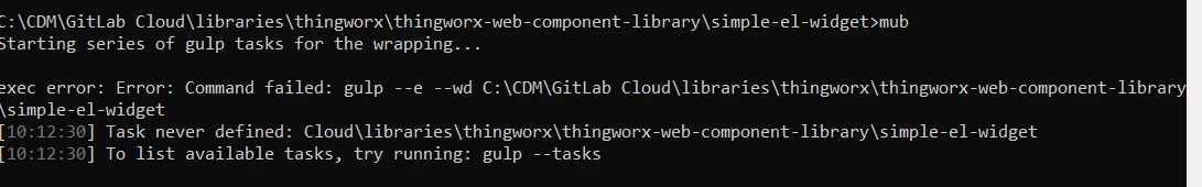

But the mub command gives me back this error:
Starting series of gulp tasks for the wrapping...
exec error: Error: Command failed: gulp --e --wd C:\CDM\GitLab Cloud\libraries\thingworx\thingworx-web-component-library\simple-el-widget
[10:12:30] Task never defined: Cloud\libraries\thingworx\thingworx-web-component-library\simple-el-widget
[10:12:30] To list available tasks, try running: gulp --tasks

Hi @AlessandroN ,
Looking at the error message, it might be because of the space in the folder name:
Can you rename the "GitLab Cloud" folder to something else? Like "GitLabCloud" and try again.
