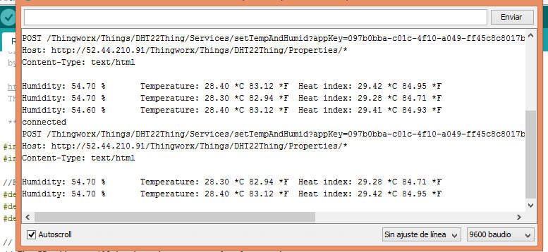

Here is the sketch running:
I´d apreciate if anyone can help me, thanks.

Hey Alvaro,
Can  you please try changing:
char server[] = "http://52.44.210.91/Thingworx/Things/DHT22Thing/Properties/*
to:
char server[] = "52.44.210.91'​
or, possibly, char server[] = "http://52.44.210.91/Thingworx/​ and see if you have the same result?
It looks like you are trying to post the values to a service, but you have the host set as the update properties URL rather than the server name.
Thanks!

Nov 28, 2016 4:50 PM UTC
Thank you, it is showing the correct values now.
