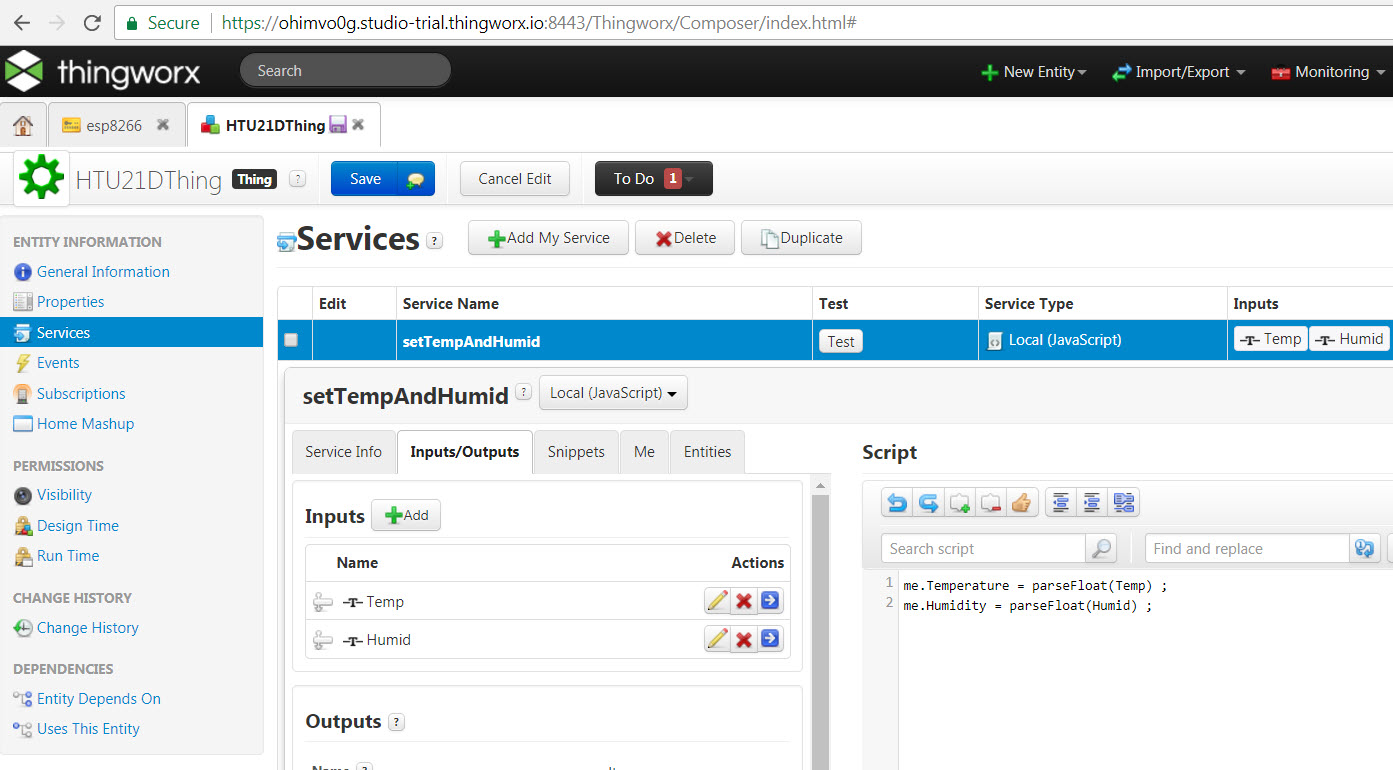

I try to connect a DHT22 sensor by ESP82266 and send the data to the Thingworx.
I tried to edit the Weather App with Arduino Uno Codes. I can connect the Thingworx server.
But I have been unable to show the data from the sensor in the Thingworx platform,
The Serial Monitor show the information as below
Connected to AndroidAP
IP address: 192.168.43.142
Thingwork Server connected
POST /Thingworx/Things/HTU21DThing/Services/setTempAndHumid?appKey=287b9c77-983c-4abf-9f75-4fc273c7183a&method=post&x-thingworx-session=true<&Temp=25.20&Humid=45.80> HTTP/1.1

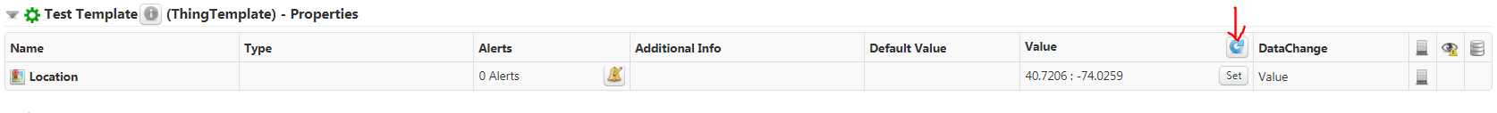

I used the below script in an Adafruit Huzzah Feather to set a Thing Property value (PUT request).  I used a DS18B20 to get the temp, but it should be easy to reuse the code and just change out the source of the variable being sent to Thingworx.  You will need to update the following sections in the script:
<YOUR_WIFI_SSID>
<YOUR_WIFI_PASSWORD>
<THINGWORX_SERVER_NAME_OR_IP>
<THINGWORX_SERVER_PORT>
<YOUR_THING>
<YOUR_PROPERTY>
<YOUR_APP_KEY>
Code Starts Below-------:

September 18, 2017
Hi Adam Sanordontri,
Could you please try the following and see if it works?
Find the line char server[] = "ohimvo0g.studio-trial.thingworx.io"; in the code and update to char server[] = "ohimvo0g.studio-trial.thingworx.io:8443";
Save and upload the program to your ESP8266 board.
Go back to your HTU21D Thing properties section, click on the refresh properties button and see if the values are being updated constantly.
If this doesn't solve the issue you can revert to original settings.

September 19, 2017
I apologize for the inconvenience. Could you please revert the settings to the default, run the code on ESP8266 board and see if you can find any errors in the application log.

April 18, 2018
I had troubles getting my ESP8266 to connect until I started using the IP address instead of the server name.  I am no where near a network person, so I have no idea why the IP worked and the server name did not.
