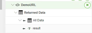

We are trying to use URL property of a web frame dynamically. We have binded the URL property with our service output. But the frame doesn't open/load the URL.
If I keep the URL property as hardcoded string instead of binding it to service opens up the URL.

As per your image of framebinding, You have binded the service Result - Output from SelectedRows to WebFrame - URL Property.
Can you please try to change with All Data > Result - Output and check it once?

We are currently on 9.3.9-b1648.
what i am trying to acheive:-
I have 2 buttons, button1 and button2 and a webframe.
On click of button1 I want to load abc.com on webframe and on click of button2, I want to open xyz.com.
So on click of button1 or button2 i trigger a service which returns either abc.com or xyz.com based on button click.
problem:- if i hardcode URL in webframe widget instead of binding it, it opens the page. but if i bind it with the services, the page does come in webframe. I have checked output of the service which is correct.

HI @Vimal_Rawat ,

Changing the binding from selectedRows to results did work.
But i am not clear when to use result and when to use selectedRows. i had an impression that i can bind either of them and it would be same result.
