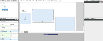

I was wondering regarding web frames. I have attached a picture of a static mashup and a web frame.
There is a grey border around the web frame which in this case shows a .jpg of the google logo. This is also the situation in responsive mashup with layouts.
My question is. Is it possible to get rid of the grey border? - If not, where do I propose a change/improvement?
Best answer by slangley
Hi @jonasf.
We created myWebframeBorderClass using the custom CSS editor and applied this class to the widget:
.myWebframeBorderClass .widget-webframe-container {
    border: 5px solid #9a9fa6;
Give this a try and let us know if you still have questions.
Regards.
--Sharon

Hi @jonasf.
Is your screenshot from a laptop/desktop browser?  What version of ThingWorx are you running?  What selections did you make when creating the mashup?
Could you please export the mashup and post it here?
Regards.
--Sharon
jonasf12-AmethystAuthor
May 13, 2019
Currently using ThingWorx 8.4.2-b2151 and the screenshot is taken on a desktop browser in the view mashup window. The settings are found below.
As mentioned earlier the mashup is a static frame but the same behaviour exists with a responsive mashup where layouts are used.
