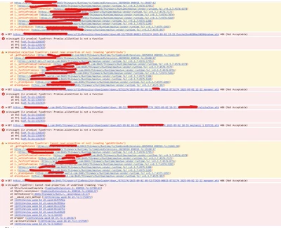

Jamal Ashraf
Sep 22, 2025 12:47 PM UTC
i have an expression which prepares a url for me for pdf and it works fine for webframe widget but for thingview widget these errors appear in console and sometime it cannot open pdf also.. and it convert also in request as u can .pdf to etb ..
what can be the reason here? any idea thanks
