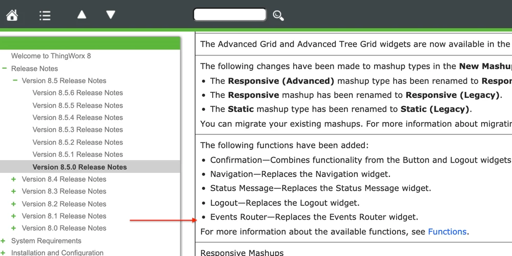

What if i have to bind two Functions output/result to Disable property of a Button
Hi ,
I  have facing issue with Binding Two function's Result to Disable property of a Button. i am able to bind only one result to Disable property, but i have another function with different expression and for this also i need Disable the button.

Use EventsRouter Widget.

A thing service can be created to implement the logic. The result of the thing service can drive the button disable property.
June 15, 2020
Can't find EventsRouter widget in 8.5.3 now.  Can use the Experssion function in the mashup (lower right corner) to combine 2 inputs to 1 Boolean output.

EventsRouter on 8.5 it's now on the Functions side of the Mashup Builder:
