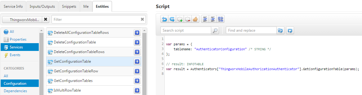

I want to get the ConfigurationTable of a custom Authenticator via a service of a Thing. I need to retrieve a configuration property.
To demonstrate, I am using the ThingworxMobileAuthorizationAuthenticator. The behaviour is the same as for the custom Authenticator.
Using Postman works fine, but when I try to code it using the Entities tab in the Service script, like so:

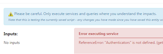

I get this error when I test it:
What does this mean?

Now, trying the following in a Service script:
var params = {
  tableName: "AuthenticatorConfiguration" /* STRING */
// result: INFOTABLE
var result = Authenticators["ThingworxMobileAuthorizationAuthenticator"].GetConfigurationTable(params);
Returns:
Error executing service
ReferenceError: "Authenticators" is not defined. (getConfigTable#6)
Details of our custom authenticator (which works successfully) isn't needed here, as the error received is precisely the same for the Thingworx Authenticator.
The custom authenticator stores a value in its configuration table during authorisation. Once logged into the instance, we need to a service that will read the property from our Authenticators configuration table.
Why does Thingworx Composer provide Authenticators under the Entities tab for coding a Script of a Service, and then throw a ReferenceError saying "Authenticators" is not defined... seems like a bug?
