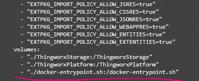

from the thingworx docker build, the scripttimeout was set to 30 in the generated platform-settings.json. I had combed through all references and "full" list I could find, but none of them mentioned the env key name for scripttimeout. I had done a blind test with "SCRIPTTIMEOUT=1220" in the docker compose yaml file, but it didn't work, just got ignored.

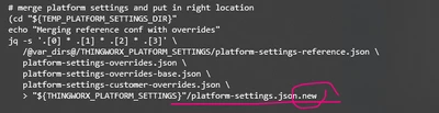

QZ_ASGRA10-MarbleAuthor
May 27, 2022
right after I knew there was no env key for scripttimeout, I made a small change to the deploy_entrypoint.sh , and then I could tweak the platform-setting.json file .
