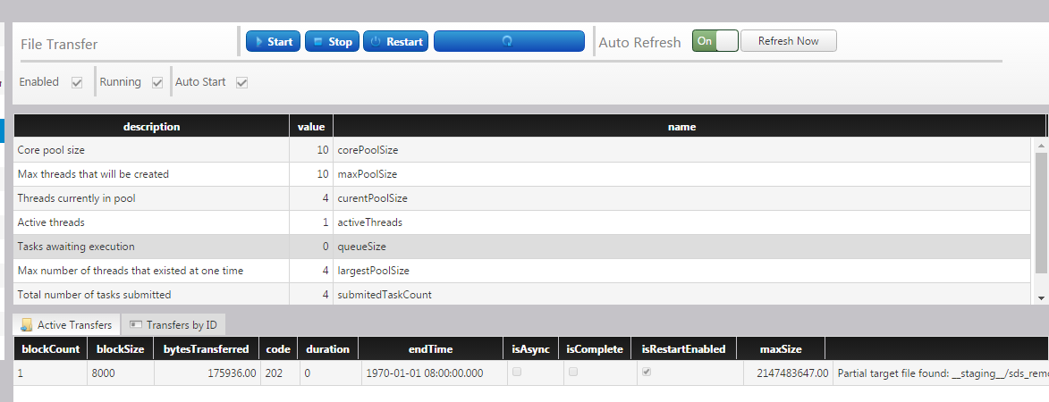

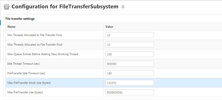

       I have a requirement to upgrade firmware to my device which  running C SDK. Now, I have make the file transfer work between C SDK application and ThingWorx platform. But question is that transfer speed is very low when I download a  bigger file from ThingWorx platform. And  I think the Max block size is reason!! I have try to set up the value of max block size in FileTransferSubsystem configuration, but it can't be set bigger than 8000 bytes.I mean whatever big value I set to it , the max always 8000 bytes when I transfer file~~

Also please note that the settings in the filetransfer subsystem (in the screenshot you show) will override the values on the edge side.

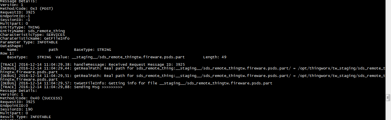

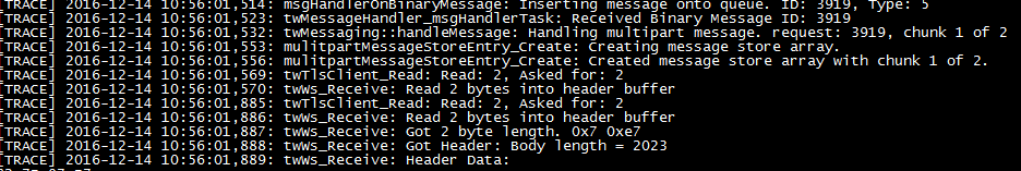

  It is useful to increase both the MAX_MESSAGE_SIZE and file_xfer_block_size.  I can  transfer my file from my C SDK to ThingWorx platform with  a normal speed now(file_xfer_block_size can be 95K ).  But there still have some question when I download file from ThingWorx platform file repository. Whenever I increase the file_xfer_block_size more than 8000 bytes, just like blow and run my program, it always stop after invoking the GetfileInfo service and print such log. And then it will print   "Time out attempting to read frame", just I have post above~~   But it can transfer file  with a slow speed when I delete this code line!!
      twcfg.file_xfer_block_size = 10000;
