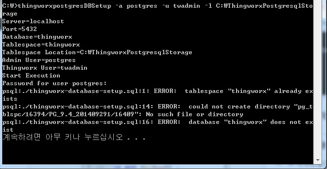

what the tablespace "thingworx" already exist?
  • March 20, 2017
  • 3 replies
  • 3077 views
I replace SET tablespace_location=C:\ThingworxPostgresqlStorage
but didn't work plz help me

    i following staka's video and download tomcat 8.0.42, postgresql 9.4, Thingworx-platform-postgre-7-1-10 on PTC support page
    but when i excute thingworxPostgresDBSetup.bat (i replace loacation "\ThingworxPostgresqlStorage" -> "C:\ThingworxPostgresqlStorage")
    apeer some error
    psql:./thingworx-database-setup.spl:1: ERROR: tablespaace "thingworx" already exists
    psql:./thingworx-database-setup.spl:14: ERROR: could not create directory "pg_tblspc/16394/PG_9.4_201409291/16409": No such file or direcrory
    psql:./thingworx-database-setup.spl:14: ERROR: database "thingworx" does not exist
    i make directory called ThingworxPostgresqlStorage in root
    and i create new role user "twadmin"
    but i can't make new database"thingworx" and new schema "thingworx"
    so, i can open appmanager /Thingworx on Tomcat localhost
    please help me why didn't make database and schema . thank for your kind.
    ps. i give Administrator rights each folder ThingworxPostgresqlStorage and thingworxPostgresDBSetup.ba

    Is this a fresh install? If so, try running the Delete/DatabaseCLeanup script first, then the installation ones.
    Also please refer to this article:Frequently Seen Errors upon launching the Thingworx application:
