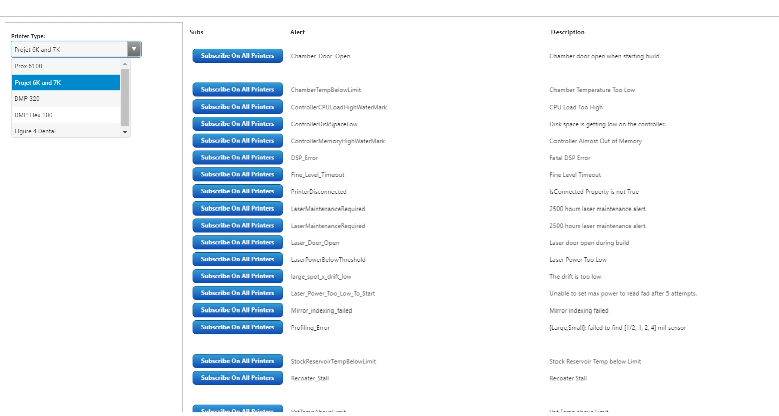

when scrolling up and down on mashup some rows are get disappearing in collection widget?
I am displaying data on collection widget after selecting one template from drop down. when i scrolled up and down some rows are get disappear or lost the data of those rows. this is happening when I run mashup,

Hi Prem,
Try to change the collection widget property UID with different field like name which should be represent unique in the data. your issue will get resolved.

for the above query am attaching the image also how my mashup is behaving.

Hi Prem,
