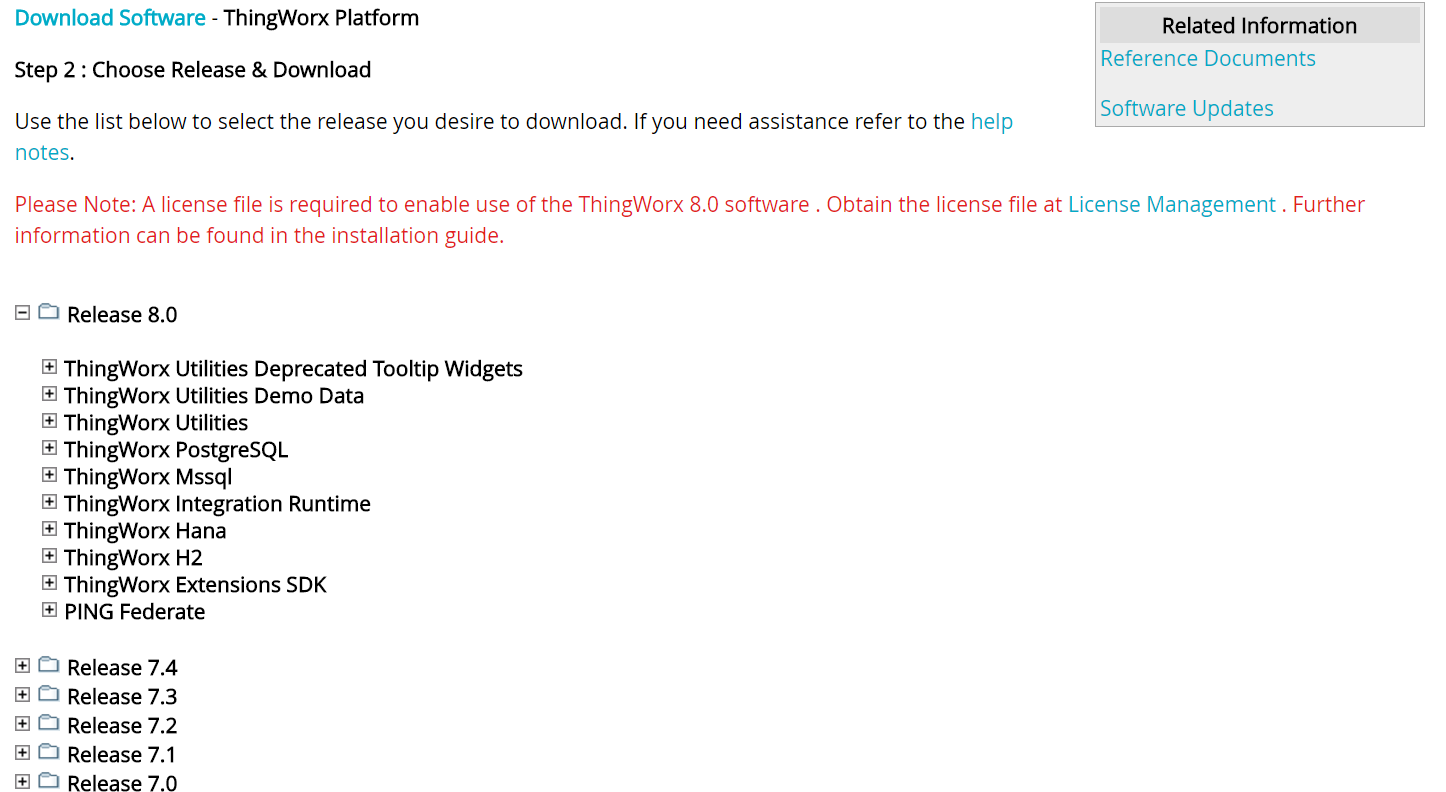

I have looked on the Thingworx downloads page, but am unsure which is the correct download for the war file.

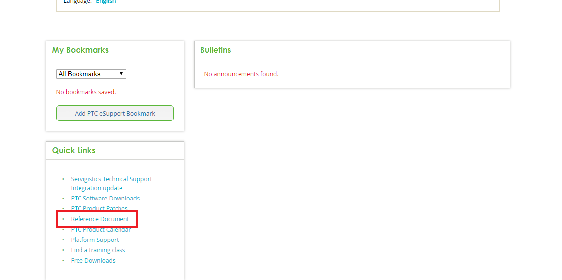

Aug 29, 2017 9:34 AM UTC
Setup local PostgreSQL and download Thingworx 7.3(no licensing hassle) for PostregreSQL.
On that support page is also Reference Documents section, where you can find complete installation guide.
