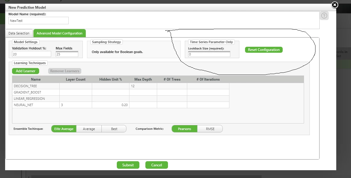

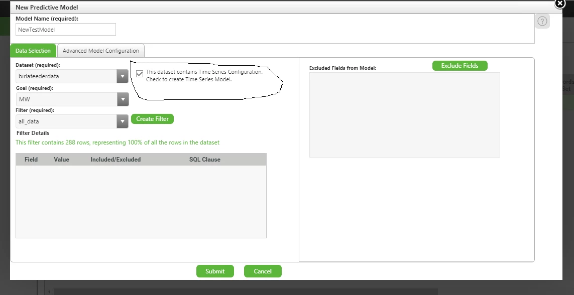

I can able set look back parameter of Time Series Prediction in the new Model, I can't able look ahead parameter in time series model?
 Herewith I have attached ScreenShot My model creation

You need to make sure you are using release 8.3 or above for all the components: ThingWorx, ThingWorx Analytics Extension and ThingWorx Analytics Server.
the look ahead setting has been added with release 8.3 - see Release Notes
Hope this helps
Kind regards
Christophe
