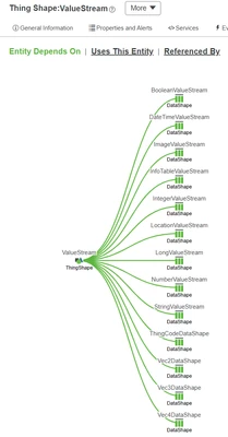

I found the system ThingShape [ValueStream]  has lots of depending entities,  while it's property, service, event, subscription are empty.   where do the relationships of the ThingShape [ValueStream] come from  ?

Those are Data Shape dependencies, used for some of the input parameters of the internal VS Services.
