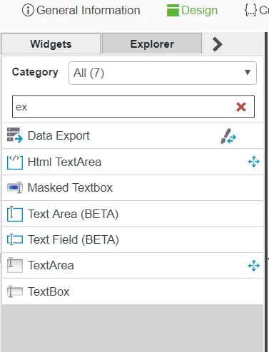

I could NOT find the Expression widgets in ThingWorx 8.4.  Does this widget get removed or renamed ?

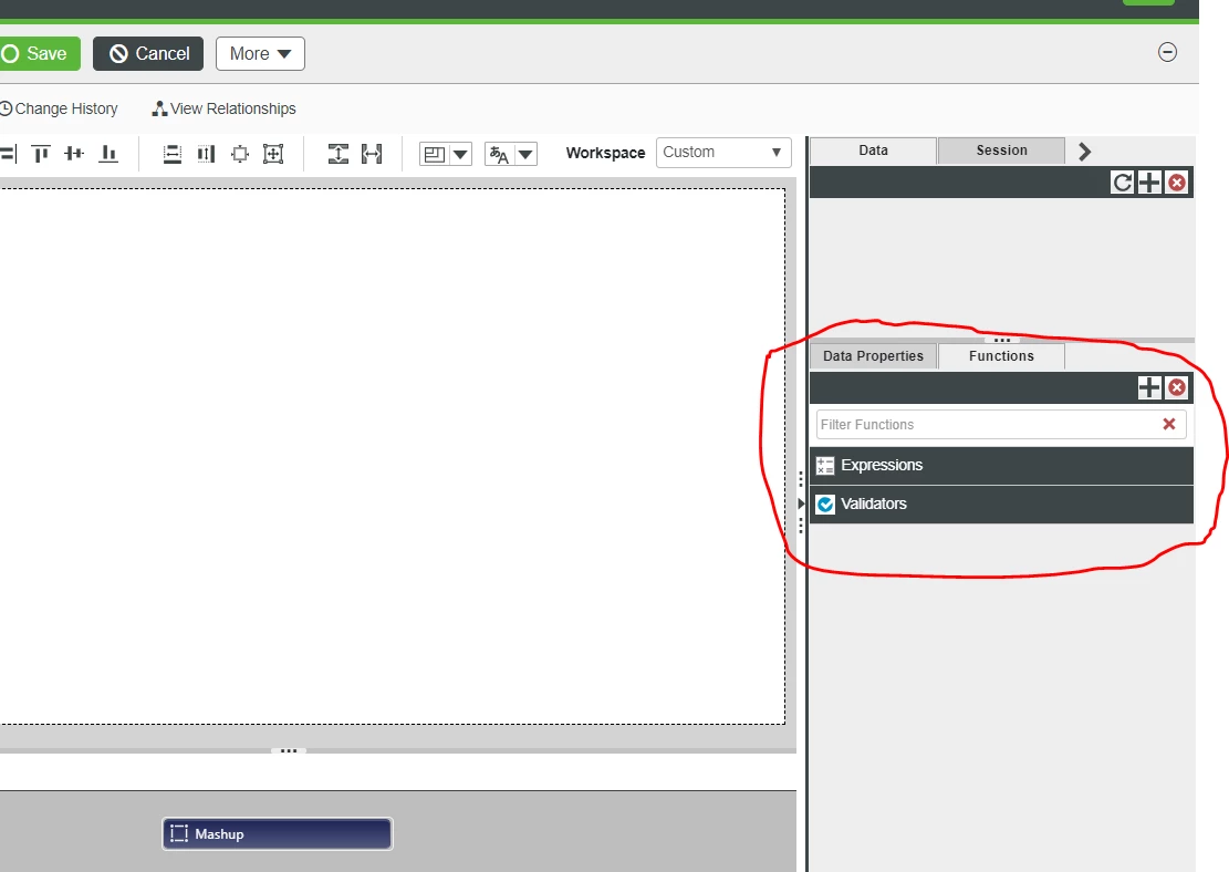

Expression and Validators widget are moved below the data section in mashup design .See the screenshot for more clarity .There is a (+) sign above these widget ,you can create a new expression/validators from the (+) sign .
