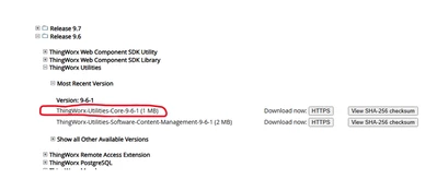

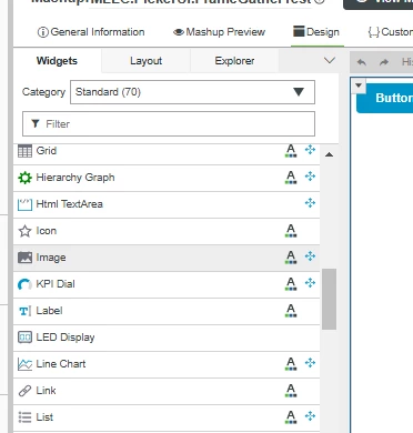

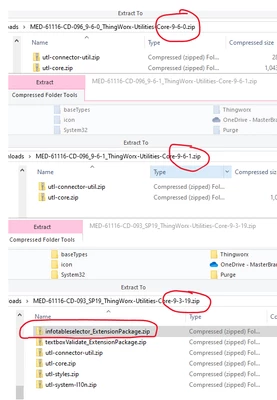

steve23714-AlexandriteAuthor
Jan 7, 2025 9:22 PM UTC
Thanks, for the reply, Abhi.
I think I've got the correct version.  I imported ThingWorx-Utilities-Core-9-6-1 into my thingworx 9.6.1 environment.
I downloaded the 9.6.0, 9.6.1 and 9.3.19 versions and as you can see from the first screenshot, only the 9.3.19 version includes the infotableselector extension zip folder, so that is why I think it's not available in 9.6.0 or 9.6.1.  The second screenshot shows it's not available in the widget list after I imported the utility.
And this is the download
