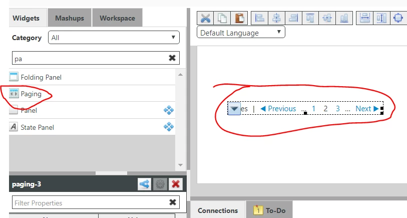

Hi ,
There is a paging widget in ThingWorx 8.3,  but where is it in ThingWorx 8.4 ?  I couldn't find it .
Sean
There is no out of the box paging widget in ThingWorx, it should come from a custom extension.
Can you review the installed extensions on the 8.3  platform ?
Stéphane
seanccc17-PeridotAuthor
@smainente
yes, the customized widget comes from the industrial apps .  But why not publish it since it already in use ?
