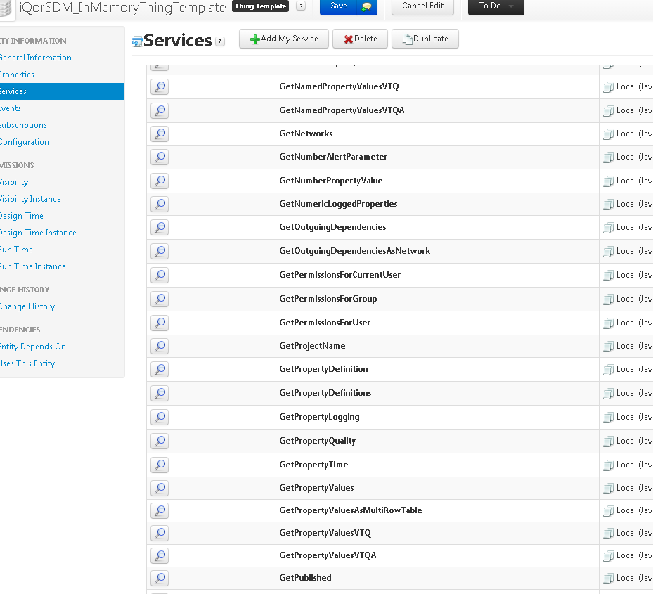

February 17, 2017
What I am trying to do is while creating a new thingtemplate, compare the properties names again existing thingtemplates
20-Turquoise
February 17, 2017
Such a service is not available out of the box. What I see as a workaround/potential solution, is to keep all existing properties in some datatable, then checking for a matching entry before creating a new property. Or running the GetProperties service that returns an infotable and comparing the row value.

aluna1-VisitorAuthor
February 20, 2017
just one thing, I do not find the GetProperties service
posipova20-TurquoiseAnswer
20-Turquoise
February 20, 2017
It's not available on the template level, but you may try to use GetInstancePropertyDefinitions with the infotable returned. Please keep in mind you cannot "test" a service on the template level, you would have to create a new service in a thing and access the template services through it.
