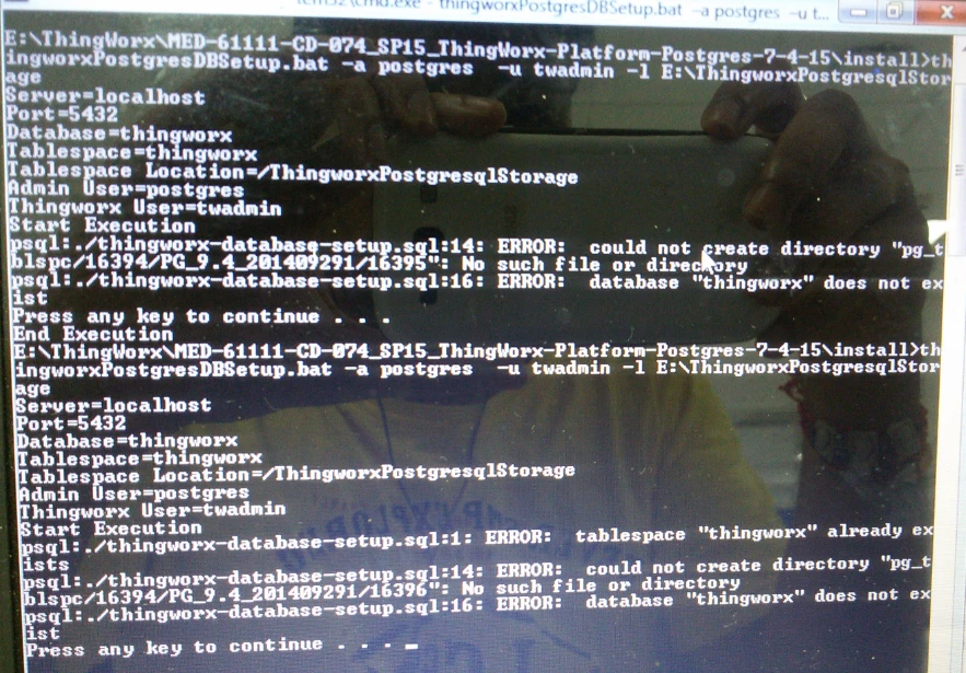

Hello ,
 While loading db in postgres I am facing error directory cannot create "pg_tblspc" while having full access in E drive for directory creation . Also I try to setup in C drive providing full access to user .

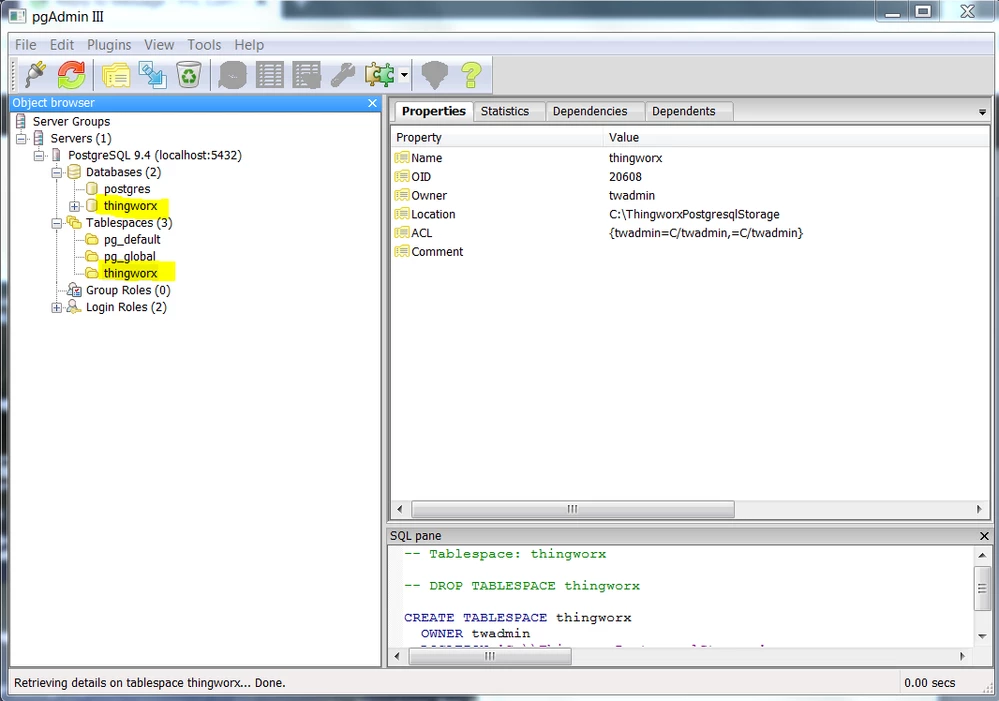

Did you run the db scripts more than once and perform some cleanup in between runs?  I can see in your screenshot, errors indicating the thingworx database does not exist but the thingworx tablespace does.  Since this appears to be a new installation, you can do the following:
1. Drop the thingworx database and tablespace by right-clicking each, then selecting Delete/Drop:
2. Make sure the login role exists for twadmin.
3. Check the \ThingworxPostgresqlStorage folder and if files/folders did not get removed after performing step 1, delete them
4.  Re-run the following scripts per the instructions in the Installation guide:
     thingworxPostgresDBSetup.bat
     thingworxPostgresSchemaSetup.bat
If you still have issues after performing these steps, please let us know.
