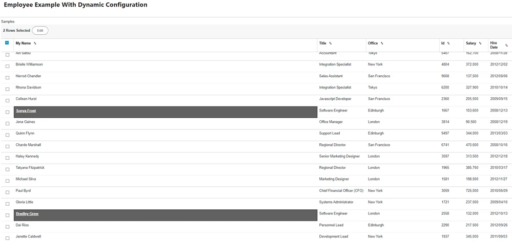

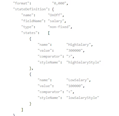

The only thing I changed was that I bound the data and configuration to a grid (instead of the legacy advanced grid) because the original mashup displayed no data. As you can see, the row formatting was retained but the salary formatting was not.

The value in the "Salary" column is using a comma. Have you tried changing this to just a normal number?
