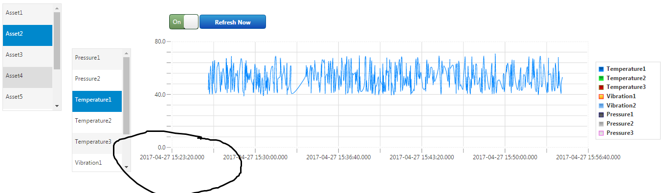

Why timestamp variation on x axis in time series chart by using value stream?
Dear Team,

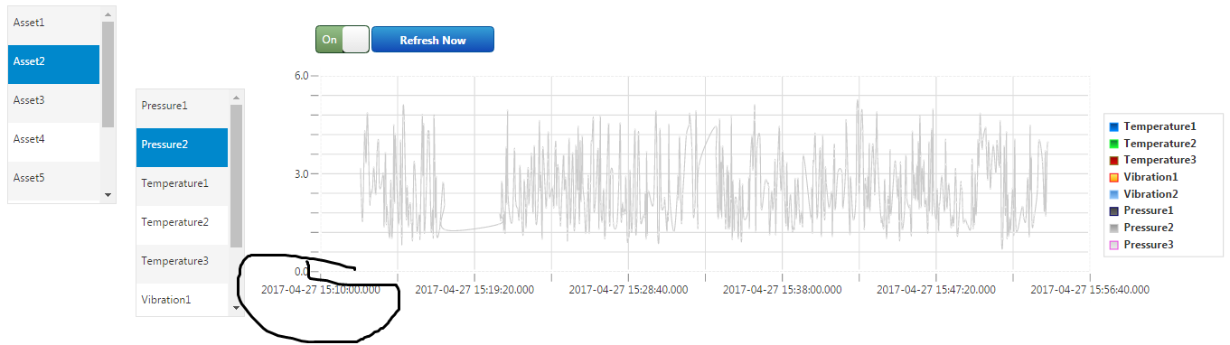

Why timestamp variation on x axis in time series chart by using value stream? I need to show fixed inertval in time series chart
Image: 1 starting time stamp    15:10:23
Image: 2 starting time stamp   15:13:23
Image:3 starting time stamp  15:23:55
I need to show fixed start time and end time for all  properties.

Hi Bhuwaneshwar, is the minimum and maximum for the X axis configured for the timeseries chart widget?
if not could you set these and test
bgupta-210-MarbleAuthor
April 27, 2017
Hi Sushant,
That is not working. I need to show value from current time stamp to previous 1 hour.
April 27, 2017
You can bind the values to those parameters as it's accepting incoming binds, basically you can have two values one picking up the current system time and then just subtract an hour from that an add to the other value. Have you already tried that as well?

Hi Sushant,
As you  said way working but auto refresh is not working. I need chart to be autorefresh and show only one hour data.
April 27, 2017
You can use the Auto Refresh widget in the mashup (you can disable its visibility if not needed) which has a refresh event which is fired when the Auto Refresh widget refreshes you can use the event to invoke the service which is setting your current date and current date - 1hour to the Time Series chart.
Hope this helps.
