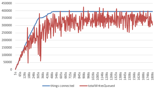

We made one edge update a temperature property increased by 1 every 5 secs. If 300k ~ 400k edges update logged temperature properties(value streams) every 5 secs concurrently, the ThingWorx Platform(TWX) could only receive/queue 85% ~ 90% of properties. When the edges' connections are established stably, We observed the 'totalWritesQueued' value of Value Stream Substem every 5 secs and computed its minus, then divided this minus by the amount of edges.
My question is, why the TWX couldn't handle 100% of properties when  more than 300k edges update properties concurrently?

Are you saying that you have 300,000 - 400,000 edge devices updating the Platform, with no Connection Server, and you are wondering why the Platform cannot handle this? The Platform is not designed to handle this many edge devices on its own. You need the Connection Server for this. Here is a KCS Article on the subject. Hope this helps!

To simplify the problem, I didn't mention the Connection Server. In fact, I made 300k ~ 400k edge devices update properties via 2 ~ 3 optimized high-performance Connection Servers. I've checked that the TWX platform can handle 200k value streams sent by remote devices every 5 secs via only one Connection Server.

Ah, so the issue can't be the fault of too many connections. You're actually not the first person to post about this, and I am pretty sure there was no resolution on the other thread. You may want to consider opening a support case for this issue. How are your properties updated? Are you sure the updates are propagating to the Platform? Are these remote properties? What are their remote bind settings?
