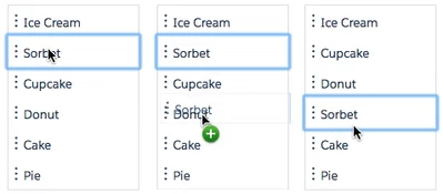

For a project, on a mashup i wanted to perform sequencing of rows in a table by drag and drop method and submit it.
How do we achieve this on thingworx UI mashup programming.
I am uploading an image for example.
Some thing similar to this for a table.

Unfortunately, you're going to need to build a custom widget using a JS library that can enable the drag/drop functionality.

As an alternative I would suggest using a pair of "Up" / "Down" buttons to the side of your list.

If you don't want to build out an extension for this yourself, you can try to install these two extensions:
And use the collection view widget (note: not the standard collection) which supports client-side sorting via drag & drop.
