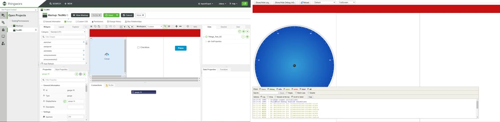

Hello! I'm currently working with Thingworx v8.5 and experiencing some issues with Mashups. As I'm adding widgets to the design it's all working as expected in the mashup builder, however, once I select "View mashup" some widgets don't appear in runtime. I tried with different widgets in the mashup and experienced the same problem with many of them.
This is not a problem regarding imported widgets since this is happening with the native widgets. There are no errors on the logs.
How can I solve this problem?

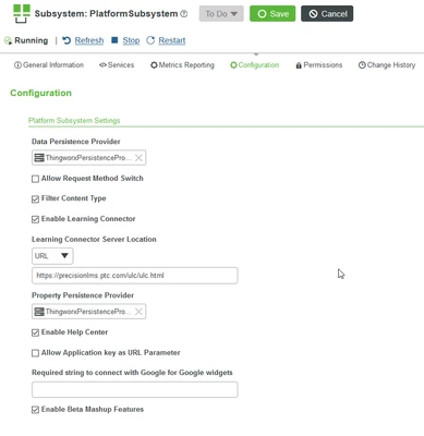

Do you have Enable Beta Widgets active in Platform Subsystem?
Raluca Edu
April 28, 2020
Unfortunately, it didn't solve the problem as the widgets still don't appear. But thanks for the suggestion!

Can you see any error in Application.log? Or in Developer Tools in browser?
