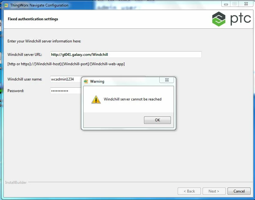

Windchill server cannot be reached.........Connection refused.
I am trying to install Thingworx navigate 1.8 using installer (600 MB file proivded on PTC website).
I don't have Windchill configured for SSL, nor i want to do it.
So i am selecting option Fixed Authentication.
I keep my Windchill server on, i can access it from browser.
So even after providing correct URL and Administrator username and password i am not able to connect to windchill.
I guess for Fixed Authentication Https is not mandatory.  Also  when i try to connect using media

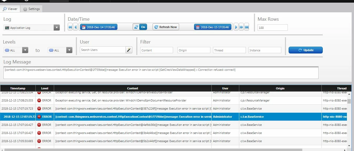

1) ptc-windchill-integration-connector-proxy
2) ptc-windchill-integration-connector
and run the LandingPageAccessAppMashup , it shows connection refused in Application logs.

It was version problem only.   When I read the Released Notes of Thingworx Navigate 1.8, it was mention that Windchill 11.1 M010  is supported, so I tried connecting with it, and it works.
