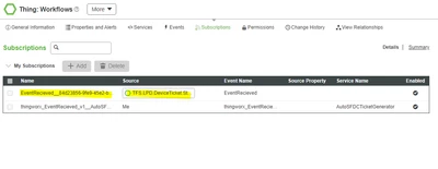

I have a created a Workflow Thingworx Trigger and corresponding 2 subscriptions getting created for that Trigger.One will be "me" and other is Custom defined.

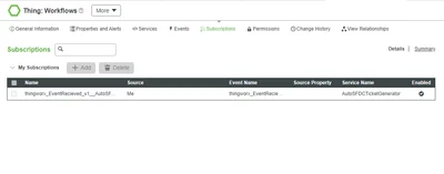

But whenever I'm trying to Export application build(including workflow) to another TWX server,one of the subscription getting deleted automatically.
Below is the scenario:
1. Two subscriptions created once a Thingworx Trigger is created in Workflow. One of them is "ME".
2. Whenever this Workflow migrates to another Thingworx composer,the Custom subscription gets deleted automatically. And I would have to edit or run the workflow trigger to generate it again.

I'm using TWX 8.5. There are no error pre and post Export.
I'm not using Solution Central but by bundling the application entities into an Extension and import it to other TWX server.
