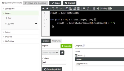

i get properties from a remote device (edge) via C-SDK.
There is one property of Type blob (byteArray) which contains multiple (0-32) bytes.
How can i work with blob?
How can i do some bit logic, like check if bit "18" is set?
Checks on the edge Device is not possible because bytes have a different meaning from device to device. Only the Plattform knows how to interpret the bytes

i found a solution for my Problem:
an abstract code to identify single bits:
let length = blob.length;
result = "length: " + length + " | ";
for (var i = 0; i < length; i++) {
result += blob[i].toString(2) + " ";
 the rest is some string magic

May 27, 2021 7:57 AM UTC
Thanks for the answer but unfortunately this does not answer my problem.
I have attached a screenshot for illustration.
I assign the input parameter of type blob to the variable result. the for loop afterwards does nothing. How can I work with BLOB in Services? How can I process the input?
By the way: the outputstring does not change if I change the blob from "asd" to for example "123".
