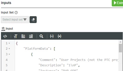

I've been working with JSON as inputs to services a lot more lately and I've noticed a strange behavior, at least for me.
When I have set the Inputs as a JSON:
And put a JSON object with an array in it (with several objects in it), something like this:
When using this object in the code and trying to push some new objects into this array I get the error saying that the .push() function doesn't exist.
"TypeError: Cannot find function push in object"

It is entirely possible that I just don't know enough about these different types. But to me it doesn't make much sense why one works while the other doesnt.
Any help with this would be much appreciated.

The issue is that you assume that the constructor used to package the input parameter as JSON is the same as the constructor used in code to build your object.
When you pass a JSON parameter between services (and this is what happens when you provide the default value for your input parameter) results in an internal object type of JSONObject. Here's a link to this object's JAVADOC to see its implementation, and here's the respective JSONArray type documentation. You will note that in there there's no push method, while it has instead a put equivalent.

Hello, thank you for your answer.
I understand that it is not possible to use .push() on an object.
However if you look closely on the Input parameter, which is a JSON type, it includes the exact same "PlatformData" array as the variable in the code.
Maybe I named the variable a little bit badly in my first post. I will change it.

To me "Input" and "localJSON" should be the exact same type, both JSON objects with an array called "PlatformData".
But it is only possibly to use .push() on one of the arrays, on the one variable declared in the code.
Hope this clears some things up.
