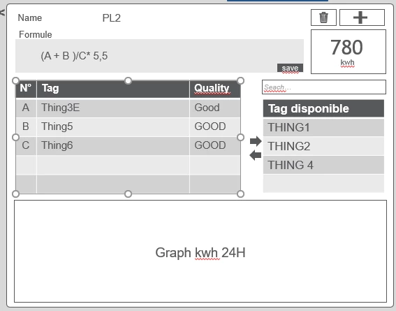

I Want to write a formula or an expression using selected rows of a grid, if you have any idea how to do it i would be grateful.
I will attach what I want to do in the mashup

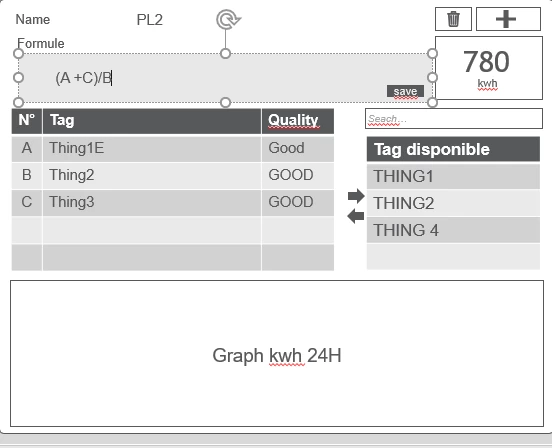

thank you @slangley for your reply,
what i want is to write an expression or a forumula( like in excel ).
So my idea is, i want to write the id of (selected  row from the grid) in a text field and do  some calculations.
For example:
if i have in my grid :
Id :A ,thing1,( with some properties: like  propValue
and I want to make a forumula between those things
formula  = A +C/B
(so the meaning behing is
formula = Things["thing1"].propValue +Things["thing3"].propValue /Things["thing2"].propValue
then this formula is applied on a propValue of our new (thing which is equivalent to an energy meter)
I Wish i was clear and thank you in advance
Hi @AN_9685270 ,
If you have predefined list of formulas and just want to take input from a grid; Then you can follow below procedure.
  • Create a custom service to use/write formulae based on your input.
  • Mashup :
    • Allow selection in grid
    • The required input for the custom service can be bound from the selected rows of the service from which grid data is populated.
    • To trigger the custom service , you can make use of SelectedRowChanged event of the service that populates the grid data.
Hope it Helps!!!
