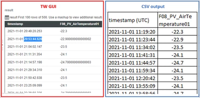

Hi I have attached an image of two end results TWX GUI is QueryNamedPropertyHistory output which is in IST, and thats allright The CSV output is what I get when writing the left handside infotable to csv using WriteCSVfile service. I expected the timestamp to be writtten in UTC (5HRS AND 30 MINS BEHIND IST) But it's getting written in EST (9hrs and 30 mins behind). This is the issue I have. I want to write the data in UTC since it does not depend on Daylight saving or such variations. I am convinced that it has something to do with the way CSV Parser is interpreting the timestamp. Please let me know if some modifications to extension could fix this issue or any other solution is available.

In what time zone does the Thingworx server hosted? and Thingworx version?
