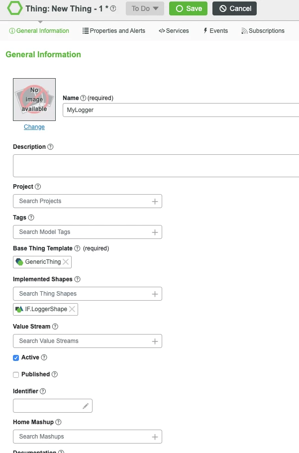

This may help: import attached extension.
Create a thing name 'MyLogger' using shape 'IF.LoggerShape'.

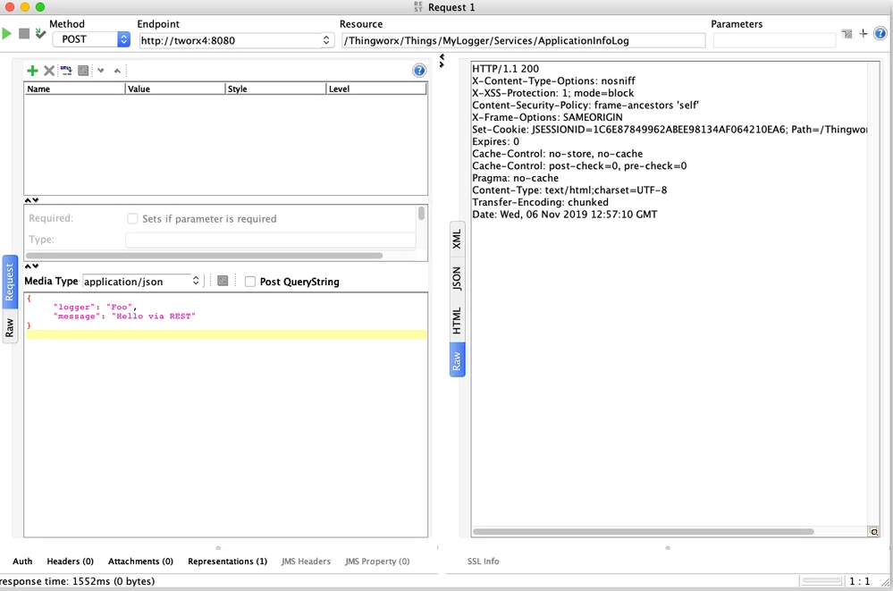

Our via REST: you need to adjust hostname (and thing-name).
http://hostname:8080/Thingworx/Things/MyLogger/Services/ApplicationInfoLog
POST body like:
"logger"": "Foo"
"message"": "Hello via REST"

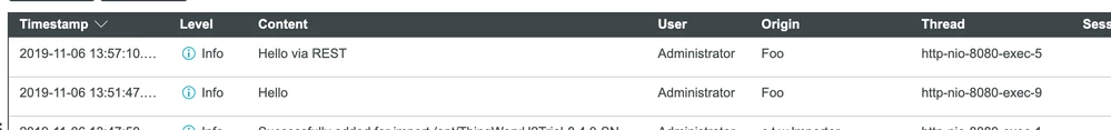

Result should be like this:
