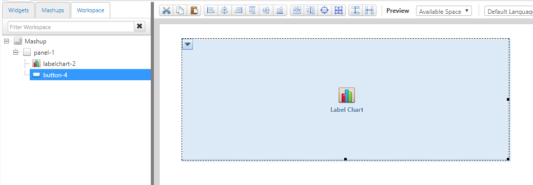

There is a common, tricky & fast (not best practice) workaround.
If your labelchart is in the panel or similar container you can add widgets, which will overlay existing ones in mashup.
In my example I added new button which has DefaultContainerStyle as a style and put it on the Label Chart.
Now you can see that it is not visible but still clickable so you can use it as a dummy Click Event on Label Chart.
