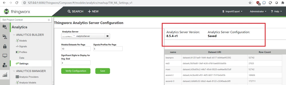

UPDATE: Following @jgreiner suggestion I updated the ThingWorx Analytics version.

Thanks for sharing you solution with us!  If you want to confirm what version of Analytics you are using in ThingWorx Composer, go to Analytics>Settings and the version should appear in the top right.
