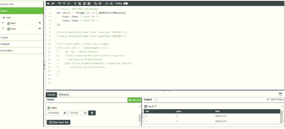

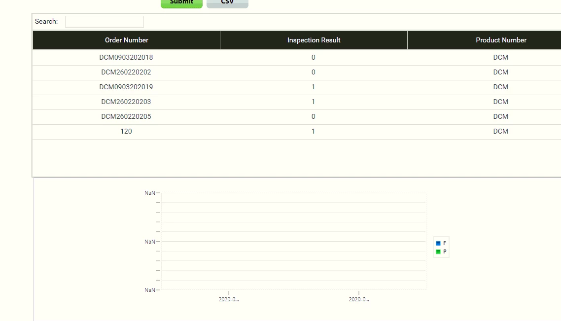

i m using label chart for my report , where i need 2 bars for single timestamp.
so i m using timestamp on x axis and on y chart i wanted to show number of passed and failed products .
so in one bar it will show how many product got passed and in second bar it will show many product got failed on that day.
i wanted to achieve this but i m not able to do this,.
for me on x axis its showing timestamp or date but on y axix its showing NaN.
data is properly coming in service.
please suggest me what settings i ned to do in my chart setting or what mistake i m doing.

If you have inputs which are fail, pass and datetime. You should be able to get a chart like
I have attached an export of my project.  If you have any questions I will try to answer them

Are you able to send an export of your mashup and entities so we can have a closer look at how this is built ?
I have made a quick test to simulate input as you indicated and that works fine to me.
Also what is the version of ThingWorx you are using ?
