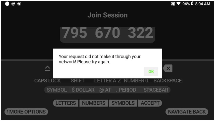

Joining Chalk Session w RealWear receive Error - Your request did not make it through your Network
  • July 6, 2021
  • 2255 views
With a newer RealWear Headset -with the latest firmware and chalk App 4.2 receive the Error "Your request did not make it through your Network. Please try again." Initiated app from IPAD also using V4.2 and can view on Desktop chalk webpage.  Used the same network connection for realwear, also used seperate network connections using hotspot, and work's on site network to try and trouble shoot.
I did use your twillio app to test the network and it passes.
Thanks in advance!
August 4, 2021
Hi KS_9005857,
We see that your account was set in a limited state. We have provided proper permissions for your account now. Could you please test it and let us know if you can join the chalk session via RealWear device.
