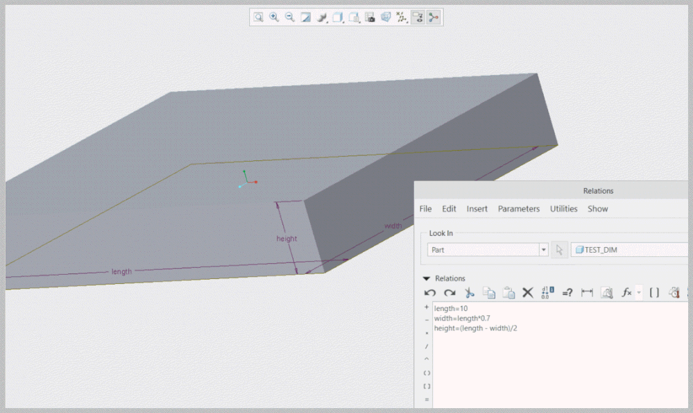

labeling a dimension and use the dimension value in the subsequent features of the model
Am using creo parametric 3.0, in which is it possible to create a labelled dimension (say thickness = 10mm) a dimension and use the dimension value in the subsequent features of the model, so that i can change the thickness once and it will change in all places.
FYI, using relations is a good option, i feel like, that requires more manual work, (defining the dimensions and then giving relations).
Thanks in advance.

Hello @vdevan ,
so far I understand your post , your meant in Creo Parametric  some thing like this:
So let  us   have this simple model model with some dimensions which are driven by parameters in a relation. What should be here the relation to vuforia chalk? What do you want to manage or the change here?  May be,  a picuture could be very helpful the understand your issue.
Or is this more related to Vuforia Studio? In this case I think the quesiton will make for me more sense - e.g. where you want to have some parametric dependencies to change the geometry?

hi Roland,
Thanks for the reply,
The problem is not about the Vuforia Studio,
It is related to modeling.
I fund that creating "Local Parameters"' is the answer.
Define local parameters and u can use in the model where ever you want.
