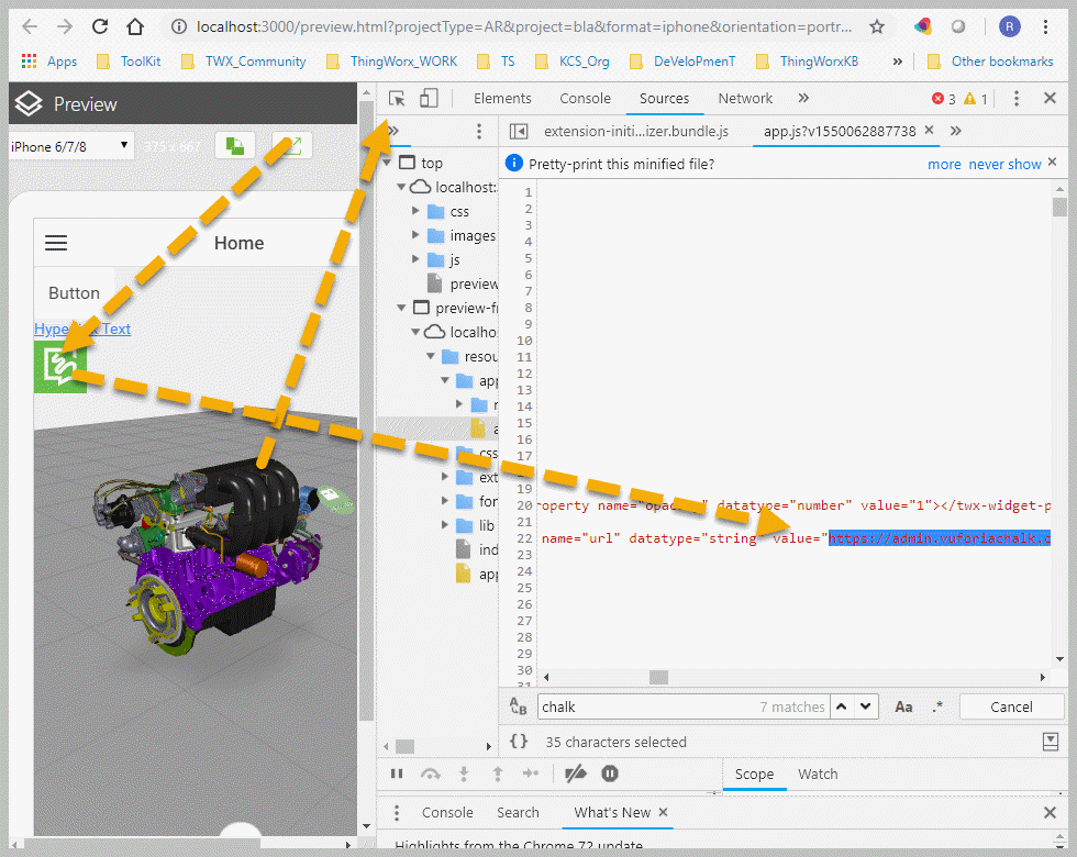

I am trying to launch Chalk from Google Assistant.
It is not taking vuforiachalk:// as the url.
Is there a way to make it work?
Also, in such a call can I fix the mail id where the call goes from google assistant?
Feb 13, 2019 1:35 PM UTC
Hi @nishantkhanna ,
I was also not able to  find an info how to call such url form the e.g.  google search. But one idea was to check what of address is used in the chalk widget:
so as shown I found there the URL :   https://admin.vuforiachalk.com/call

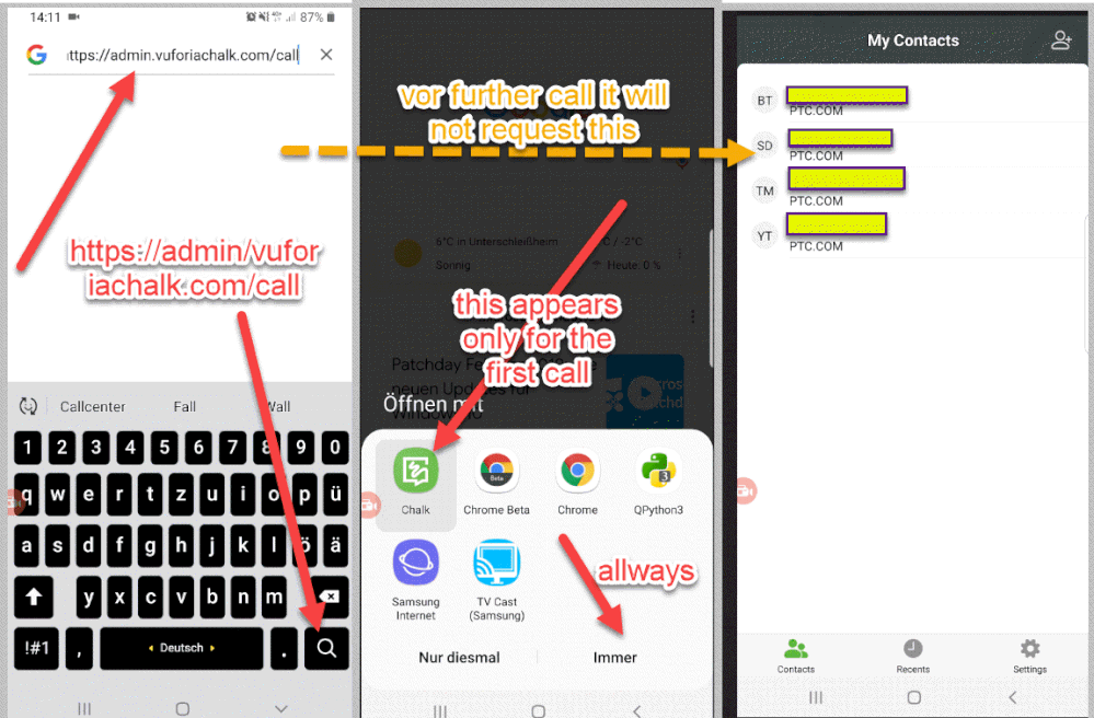

So tested it in the google search UI (see picture below) on android and for the first time it asked which application I need to call / vuforia chalk should be installed on this device.
For the second time it will call always vuforia chalk. You can test it this could help in your case (but I do not know if this is offical supported ) :
