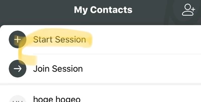

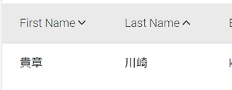

[ADDITIONAL INFORMATION]
  •  an example of user registration
  • Start Session menu of Vuforia Chalk on iOS
