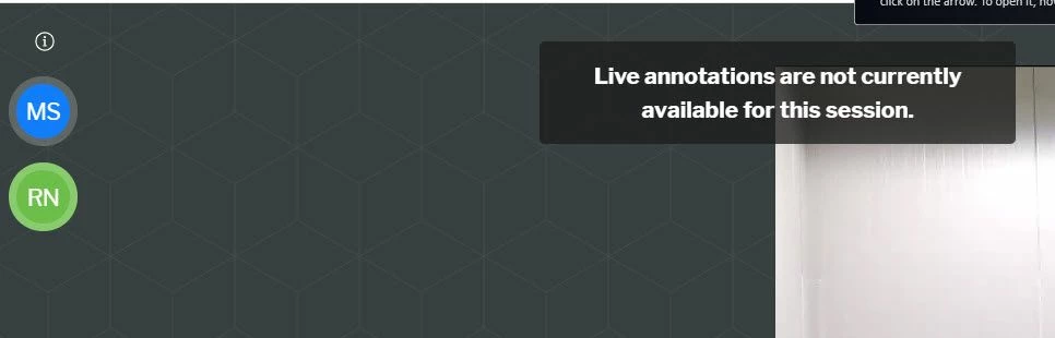

    We tried a session today but unfortunately got the message below. Is it not possible to use sketches on the screen with Chalk Desktop? Both users are hosts.

    Hi @magnus.salomons

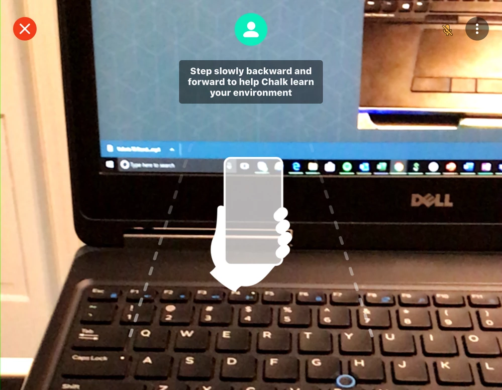

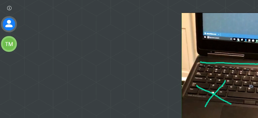

    Annotations are possible on Chalk for Desktop. Did the 'local user' (the one who was sharing their screen) follow the initial instructions displayed that allows Chalk to map the environment? It looks like this:
    Once the local user successfully does that, you should be able to add Chalk marks. I just tested locally and was able to add Chalk marks using Desktop.
